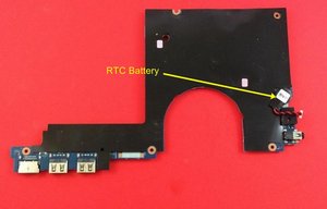

How do I replace CMOS-RTC battery of Acer Aspire S3-951?
Where can I find my CMOS battery? Compatibility? Thanks for the help!
@cpuppet101 it’s on the underside of the motherboard.
Use this guide Acer Aspire S3-951-6432 Motherboard Replacement to remove the board and to get to the battery.
That looks like the connector for the CMOS battery in the Step 2 photo to the far right of the copper cooling pipe just above another white connector. Do you see where I mean?
