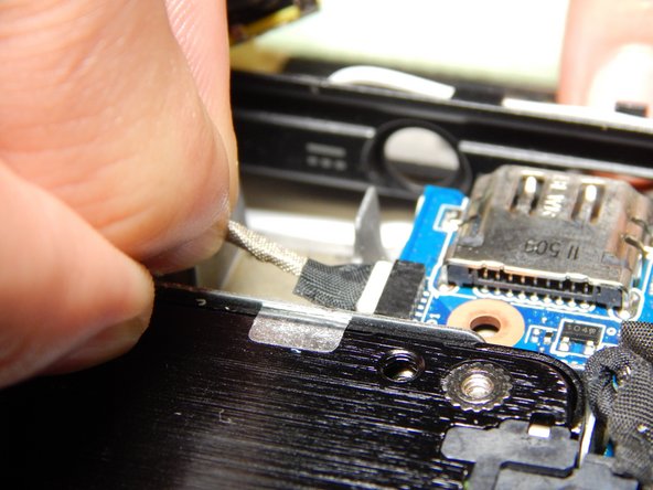

    • Locate the six cables that are connected to the motherboard. The cable with the white strip is located underneath the cable with the orange strip.
    • Using the plastic opening tool on one side and your fingernail on the other, wedge each cable out of its socket.

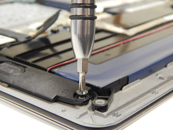

    • Locate the two speakers for this laptop that are connected above the battery by a thin red cord.
    • Using the Phillips #0 screwdriver, remove the two 3 mm screws holding the left speaker in place.
    • Pull the left speaker up along with the red cord and leave it off to the right side.
    • If you plan to disassemble the laptop down to the motherboard, you will also need to remove the two 3 mm screws holding the right-side speaker in place with a Phillips #0 screwdriver.

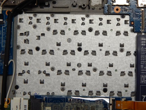

    • Without bending it, lift the entire battery (both the long black piece and the rectangular blue piece) straight up. Place it off to one side.

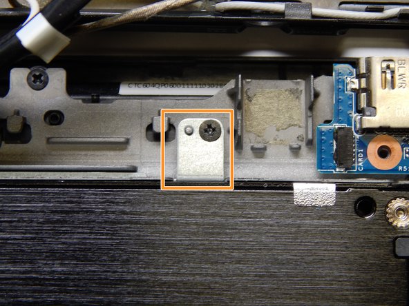

    • Using the Phillips #0 screwdriver, remove the single 3 mm screw holding the motherboard in place.
    • Using the sides of the motherboard, lift the motherboard out of the case.
