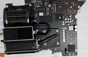

I just got a new iMac model A2115, EMC 3442 27” Intel. It came with a 256GB SSD but I need to upgrade that soon to something more a like 1 or 2 TB SSD. I have replaced HD’s quite a few time in both iMacs and Macbook’s so I am fairly familiar with the process but the issue is I cannot find any information about what aftermarket SSD will work with my machine and where you can buy one. Any and all information would be greatly appreciated. Thank you for your time.

I have the 256Gbyte Version and the SSD is soldered to the mainboard.....so how to update that?
@ peter Arbeiter it's my understanding that you don't. On the iMac 27 2020 the storage is paired to the logic board and encrypted by the Apple T2 security Chips. The storage is NOT removeable.
@oldturkey03 - There are two versions of the system! One with the soldered in SSD 256GB low end model and the removable SSD's on the high end.
The T2 doesn't affect the replacement aspect of the drive only the inability to access the data if the drive is removed from the system a new drive can be mounted.
which version of the 2020 iMac has the hard drive capable upgrade I have the 2020 iMac i7 3.8GHZ with 512GB
The process should be the same as the 2019 model iMac Intel 27" Retina 5K Display 2019 Blade SSD Replacement. The OWC Blade SSD should also be compatible Kit with 2 TB SSD
I’ll be frank I haven’t upgraded the 2020 models, but I can’t see a reason why.
Update: The iFixit guide is not physically correct as the images are from the 2019 guide. The process is the same, there is no HDD offering and depending on exact model you have the Flash storage (SSD) is soldered to the logic board only the higher models offer a removable module.

The initial, “chosen solution” to this question is dead wrong according to everymac.com and OWC. I’d hate to open a 2020 27” iMac only to discover that the blade SSD is now soldered in place. Only those 2020’s that were originally configured with 4 or 8 TB of storage have a 2nd PCIe slot to accept a replacement blade, the first half of the storage capacity being soldered in place.
@Henry Rose - Well dead wrong is a bit strong.
At the time we had limited info. If you read my answer “ The process should be the same as the 2019 mode” we didn’t expect a major change in the storage. FYI - Depending on the config you might still have a working PCIe slot.
crwdns2934275:04crwdne2934275:0
Simple answer was no ,write now i have iMac 2020 EMC 3442 came with 256 SSD it was onboard soldered to the board no SSD connector ,some one has high skill can be add the SSD connector and make it upgrade.
@rajivi8047 - You are correct, this series is a mess!
The low end models have soldered Flash chips, the two top models have a workable SSD slot. But unlike the older models which have a true SSD, these storage boards are more like the Studio and newer Mini's just holding the Flash chips! I think this was more of an experiment (product filler) as the 24" M series system was delayed.
