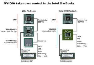

Maybe you are hitting a logic board issue within the NVIDIA Intergraded GPU chip. This was a common issue in this series.
