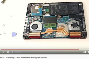

Remove the RTC coin cell battery from the motherboard. Note the orientation of the battery before removal. Usually it is +ve on top, marked on the battery. Whilst the RTC battery is out, measure its voltage. If it is <2.5V DC replace it. The battery type is marked on the battery. (CR2032?)
Here’s a image from a teardown video that may help.
(click on image to enlarge)
Press and hold the laptop’s Power button for a full 30 seconds to drain any residual power left on the motherboard and then release it. This will restore the BIOS to default.
Correctly reinsert the RTC battery, reconnect the main battery, re assemble the laptop, connect the charger and try turning it on.
