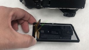

First of all, thanks a lot for the response. I just found that the flex cable that connects entire LCD to motherboard has very minor damage on the pins. When I kept the “camera on” for a while the LCD does not heat up at all, would that mean there is no power supply to the entire LCD due to flex cable damage? what other possible issues?

I have the exact same problem as @mohanlald and would like your advice. My camera turns on and EVF works, but the screen does not turn on. I have not tested the display under dim conditions yet. I bought a replacement screen, but after installing it, my A6000 still does not turn on the main screen. I then took the whole camera apart and found a tiny damage to the right most pin of the LCD display flex cable. Would this be sufficient to cause black display?

Was the pin damaged on the new LCD unit's video flex cable?
If you mean the pin on the video cable that is closest to the smaller backlight power cable connected to the LCD unit, looking at the block diagram on p.4-1 (p.7/54 pdf numbering) of the service manual I linked in the answer below it shows that it is the CSX lead - LC-1018 FLEXIBLE BOARD CN-8040 connector that connects to the LCD unit. Not sure what it's function is but it is grouped in with the other control leads to the LCD unit so it may have something to do with how the display behaves.

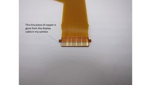

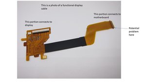

Hello everyone,
To summarize, I have the same problem as  @mohanlald. Everything else functional, but the display is black. Replaced with new screen, but it did not fix anything. I then suspected a problem with the LCD display/flex cable and then disassembled the whole camera. I noticed a very tiny copper piece missing from the LCD display cable. I could not get my camera to focus on something so small, so I created a few graphics to explain the potential problem. Just wondering if that missing piece of copper is enough to cause a black display.
Did you fix the problem by any chance?
