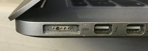

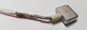

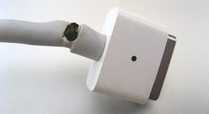

Inspect your MagSafe cord for damage like:

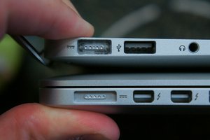

Also inspect the pins

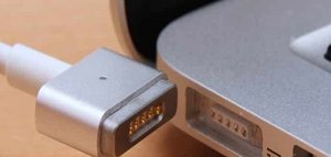

As well as the systems contacts and the insulator area make sure both are clean
Use some isopropyl alcohol and cotton swabs (Q-Tips) to clean both. You may need a fresh pink pencil eraser to polish the contacts
Did that fix things? If not you’ll need to inspect your connections focus on the I/O board MacBook Air 11" Early 2014 I/O Board Replacement you may need to replace it if the contacts look burnt like this one
