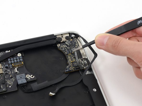

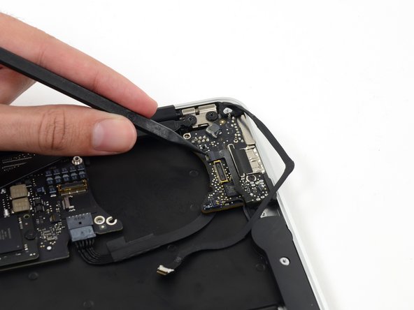

  4. MacBook Air 11" Early 2014 I/O Board Replacement, I/O Board Cable: crwdns2935265:04crwdnd2935265:01crwdnd2935265:02crwdne2935265:0 MacBook Air 11" Early 2014 I/O Board Replacement, I/O Board Cable: crwdns2935265:04crwdnd2935265:02crwdnd2935265:02crwdne2935265:0
    • Use the flat end of a spudger to pry the left and right I/O board cable connectors up off their respective sockets on the I/O board.

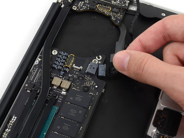

  13. MacBook Air 11" Early 2014 I/O Board Replacement, I/O Board: crwdns2935265:013crwdnd2935265:01crwdnd2935265:02crwdne2935265:0 MacBook Air 11" Early 2014 I/O Board Replacement, I/O Board: crwdns2935265:013crwdnd2935265:02crwdnd2935265:02crwdne2935265:0
    • Disconnect the I/O board power cable from the logic board by pulling the cable out of its socket on the logic board.
    • Pull the cable parallel to the face of the logic board toward the front edge of the Air.

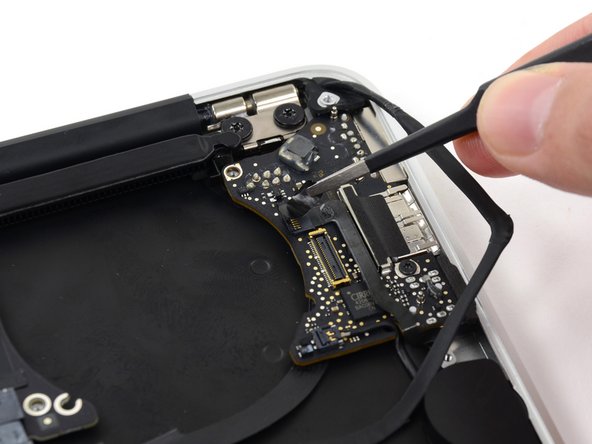

    • If necessary, use tweezers to remove any tape covering the microphone cable ZIF connector.
  15. MacBook Air 11" Early 2014 I/O Board Replacement: crwdns2935265:015crwdnd2935265:01crwdnd2935265:03crwdne2935265:0 MacBook Air 11" Early 2014 I/O Board Replacement: crwdns2935265:015crwdnd2935265:02crwdnd2935265:03crwdne2935265:0 MacBook Air 11" Early 2014 I/O Board Replacement: crwdns2935265:015crwdnd2935265:03crwdnd2935265:03crwdne2935265:0
    • Use the tip of a spudger to carefully flip up the retaining flap on the microphone cable ZIF socket.
    • Be sure you are prying up on the retaining flap, not the socket itself.
    • Pull the microphone ribbon cable straight out of its socket.

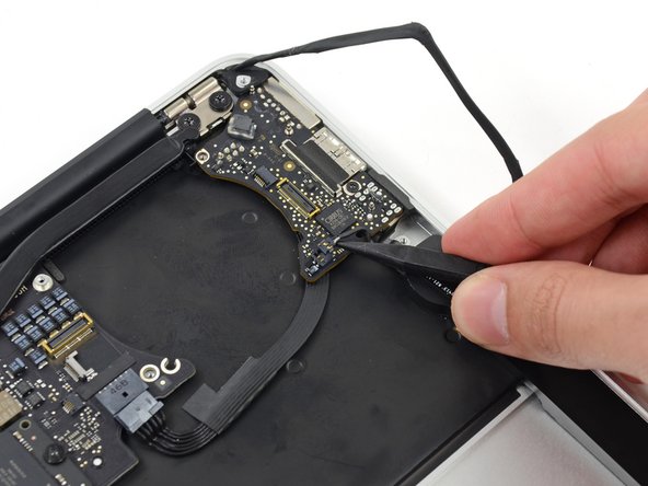

    • Use the tip of a spudger to pry under the speaker cable near the connector to lift the connector straight up out of its socket.
  17. MacBook Air 11" Early 2014 I/O Board Replacement: crwdns2935265:017crwdnd2935265:01crwdnd2935265:02crwdne2935265:0 MacBook Air 11" Early 2014 I/O Board Replacement: crwdns2935265:017crwdnd2935265:02crwdnd2935265:02crwdne2935265:0

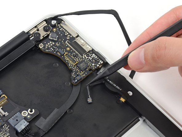

  19. MacBook Air 11" Early 2014 I/O Board Replacement: crwdns2935265:019crwdnd2935265:01crwdnd2935265:01crwdne2935265:0
    • Remove the single 3.6 mm T5 Torx screw securing the I/O board to the upper case.
    • In some models this is a 3.1 mm T5 Torx screw.
