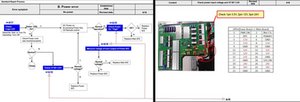

Hi @hadley8899,
Here’s a composite image taken from the service manual for the TV chassis (ED53E) that may help. I realize that the TV model number on the service manual is different but I think that your model shares the same chassis so hopefully it will be relevant.
(click on image to enlarge for better viewing)
Hopefully this is of some help.

@hadley8899
Did you try the original mainboard with the new power board?
The flowchart says to check that the "Power On goes high" (pin 1 on the power board) i.e. voltage changes from a low state to a high state. This is a signal from the mainboard that tells the power board to turn on. I think that no other voltage readings means that this is not occurring. Power board turning on I mean.
I don't know what the voltage changes to, perhaps from 0V to 3.5V as this is all that is being supplied to the mainboard from the power board at standby, so maybe that is all it can signal back until the power board is turned on.
