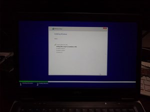

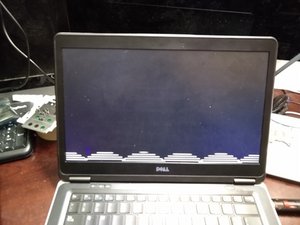

Went with the nuclear option. Tired of fighting the previous install.
Yes this weird graphical issue is not unusual for me and it also happens on my 840 G3 - this is not unique to Dell. It has no effect on the final installation so I can't justify finding why.
