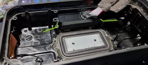

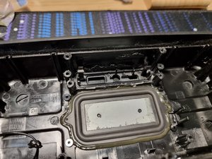

If it is still of interest for someone, I uploaded two images regarding the disassambly of the charging platine.
The green mark show the position where you can place some tool to level out the charging platine.
Make sure to use only gentle force, to not break the extension that holds the screws.
The plate is glued at the bottom, so you will hear a noise indicating that the glue comes loose.
I was able to disassable it by levering a little bit on the one side, then the other and repeated until it came apart.
