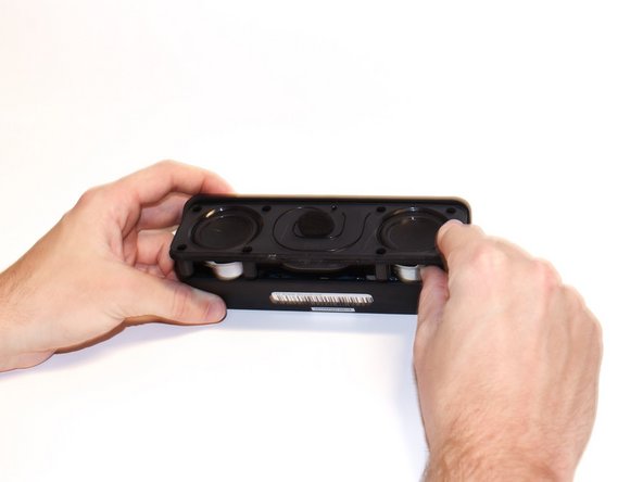

      • Remove the eight 10 mm Phillips #0 screws from the speaker mount.
    3. ANKER SoundCore Charging Port Replacement: crwdns2935265:03crwdnd2935265:01crwdnd2935265:02crwdne2935265:0 ANKER SoundCore Charging Port Replacement: crwdns2935265:03crwdnd2935265:02crwdnd2935265:02crwdne2935265:0
      • Use the metal spludger to pry off speaker mount.
    4. ANKER SoundCore Charging Port Replacement: crwdns2935265:04crwdnd2935265:01crwdnd2935265:01crwdne2935265:0

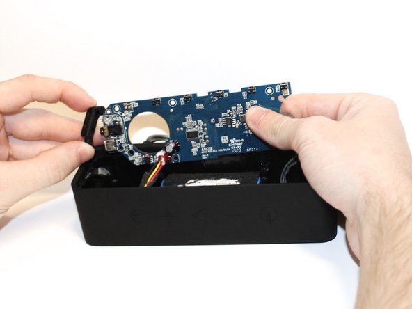

      • Remove the two 8mm Phillips #0 screws from the circuit board.
    5. ANKER SoundCore Charging Port Replacement: crwdns2935265:05crwdnd2935265:01crwdnd2935265:02crwdne2935265:0 ANKER SoundCore Charging Port Replacement: crwdns2935265:05crwdnd2935265:02crwdnd2935265:02crwdne2935265:0
      • Carefully remove the circuit board from the speaker body.
    6. ANKER SoundCore Charging Port Replacement: crwdns2935265:06crwdnd2935265:01crwdnd2935265:02crwdne2935265:0 ANKER SoundCore Charging Port Replacement: crwdns2935265:06crwdnd2935265:02crwdnd2935265:02crwdne2935265:0
      • Use the iFixit Opening Pick to pry off the charging port cover.
      • Remove the charging port cover.
    7. ANKER SoundCore Charging Port Replacement: crwdns2935265:07crwdnd2935265:01crwdnd2935265:02crwdne2935265:0 ANKER SoundCore Charging Port Replacement: crwdns2935265:07crwdnd2935265:02crwdnd2935265:02crwdne2935265:0
      • Desolder the charging port from the circuit board.
      • Solder a new charging port in place of the old one.
      • For help soldering and desoldering, follow this guide.
