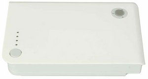

What does the onboard Battery checker tell you? Are all four LED’s lit when you press the checker button.
I would start there.
crwdns2944067:012crwdne2944067:0:
Battery light remains completely off regardless of whether AC power is connected. Have left the device charging for 1+ hour, come back and I press the button with zero LED response. Does this particular machine not boot off AC power alone? Thanks!

Without a working battery you have no means to keep the system running. Time to get a good battery
Here's a cheap one: Apple iBook G3 12 M7698LL/A Laptop Battery BB-191227
