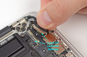

hi everyone. my computers screen flashing and then goes black when it is overheated. because when i blow out my breathe several times from the back hole of my macbook,it goes normally for a few minutes and then same issue happens. do you know why it happens and whats the solution? if u help me i really appreciate. ( i cleaned the fan and applied a new thermal paste but still same)

i had to make the image smaller because of the upload warning. i disconnet the display data cable as you said,both sides look clean and like a brand new.

izzet safak - You'll need to take one one picture of the cable as you gave us the back side ground plane, we need to see the contact side.
This looks like a bad backlight. Open your system using this guide MacBook Air 11" Mid 2012 Display Assembly Replacement follow it to Step 3, then jump down to Step 19 & 20 take a clear picture like this one so we can see the cable contacts and the logic board connectors solder joints

izzet safak - Good! So we now know the issue is not within the logic board side connection of the LVDS cable.
Now the other shoe...
We have the same connection on the displays T-CON board. We will need to inspect it as well as the cable as it passes through the hollow hinge.
You may only need to replace the cable. Follow the guide through as you'll need to take off the black plastic clutch cover to gain access to the connector. Here's the needed part MacBook Air 11" Hinge - Right/w LVDS Cable
Make sure there is no corrosion on the T-CON board. If you do you'll need a new display assembly then MacBook Air 11" Complete Display

@danj I think my problem solved but I don’t know how. because the charging sockets (both adapter and system side) were so hot before and I think this causes that problem. Now it is cold like an ice and the problem is gone.
I don’t know what I did but it is OK now :)
@izzet safak - Sadly you didn't fix things. You still have a short within the LVDS cable. What is happening is you disturbed the cable enough to break the short. The reason the MagSafe was hot is the short was pulling a lot of power which causes the connector to heat up.
