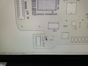

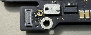

I did change 2018 (A1989) screen to 2019 (A2159) and while testing the result, I touched the touch bar digitizer connector by chance and it was overheating. After that, the screen worked well but the touch bar didn’t work (By the way, I did not remember testing the touch bar before replacing the screen so I was not sure if it was working before that or not). Then I ordered a touch bar from Aliexpress to replace it. However, after the replacement, the LCD part worked (it means I could see all the images) but the digitizer did not respond to touch.
I then tested the voltage of the L5100, and on pin 1 (the digitiser connector side) was really low (it was around 1v when it should be around 5v), also the resistance of the L5100 was very high. Fortunately, I had a dead logic board of the same model so I replaced the L5100. After that everything worked as it should be.
[image|

Thanks Dan. When I think about it, it looks more likely that the touch bar problem happened by the connector was not fitted properly and created a short. Because after replacing the new touch bar it worked normally. If the screen were not compatible it would damage the new touch bar. So we have to be careful when connecting the Touch Bar connector. Thank you for your advice.
