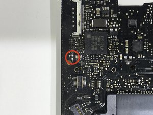

Before you go to far into replacing parts lets see if we can narrow down what needs replacing. Once you get the needed tools to pop off your bottom cover lets see if we can start the system using the power pads.

Are there any guides here on starting using the power pads?
Just short across them. If the system fails to start you have a dead battery and/or the charging logic within the logic board needs repairs.

Ok, the tools arrived the other day, and I attempted to start it using the power pads. I found this link from another thread that helped me identify them: https://www.insidemylaptop.com/turn-on-m.... I connected the charger and put the battery back in, but was not able to get it to start even after numerous attempts to bridge the pads. Next I guess I’ll try ordering a new battery and see if that does it.
@stewedtweeds - I'm confused?? I posted the power pad location for your exact system (Late 2008 & Early 2009). If the pads where somewhere else then we are working on a different model.

@danj I guess the photo looked different because it was taken with the logic board out of the computer. Looking closely, it's the same. Sorry for the confusion, and thanks for the suggestion about the connector.
