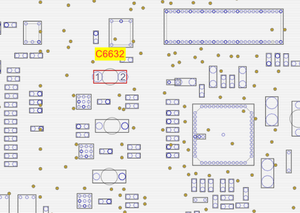

Any one know what this part is? It appears to of “blown up” on my logic board laptop still works to an extent but has been crashing at random times. I want to attempt to replace this part before spending 400$ on a new logic board.
2010 Mac Pro 15” Unibody 2.66Ghz logic board.
The component that failed is a tantalum capacitor C6632 which is a 100UF 20%, Case - AL1
