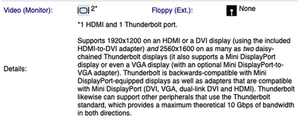

It serves me quite well as I only do basic computing, but I am interested in maximizing the quality and resolution of my monitor, buying a used one on FB Marketplace or the like. I am currently using a very old HP monitor and only getting 1680x1050. :(
My question is: what is the largest resolution that my system can handle and what should I be looking for in a used monitor?

Sadly, you won't see anything better than 1920x1200 via HDMI
This is a bit confusing! As you would need a Thunderbolt based display or a DisplayPort based display and it needs to support the newer spec.
You might want to look at the new 2020 Mac Mini with a 5K/6K display support if you need ultra high graphics. I'm thinking on getting one to replace my tired 2011 27"
@danj - it seems like the max resolution is 2560x1600, no?
@amr1001 - Sorry no, the best the 2011 model can offer is 1920x1200
You would need one of these to get 2560x1600 Late 2014 Mac Mini
@danj - This is from the link you shared for the Mid-2011 model: "....as well as a new "Thunderbolt" port that is backwards compatible with Mini DisplayPort and likewise supports an external display at 2560x1600 and passes an audio signal as well."
@amr1001 - Ah... We are mixing things here! Lets use a model to describe this conflict
The car you just bought has a engine which can offer 1920 HP and your tires can support upto 2560 HP
What is the maximum your car can run? Sadly the smaller number as the cars engine can't push what the tires can support.
