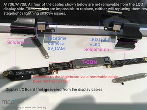

Sadly your issue is within the T-CON logic in your internal display. Here’s a more detailed view of the T-CON
You’ll need to replace the display assembly MacBook Pro 15" Touch Bar Late 2016 Screen Replacement

Thank you. How do you know, that the problem isnt on the logic board?
Your statement "The MacBook works flawlessly on the external display" The MUX logic would have messed the external display up not the internal. In addition there's a history of issues with the T-COM logic in the newer 2016 onward systems as unlike the older models it was placed inside the main case near a high heat area which cooks it. Slather on some BBQ sauce and baste it ;-{
So is it almost certain that the problem is in the T-Con? Will heat damage a particular chip or create a cold joint? I have a logic board pulled out, so I could try to heat the t-con board to a high temperature, if it's a cold connection, it should work temporarily. Given the price of the display, I would like to be sure that it is it before ordering. Thanks for the info
I have no magic here, sorry.
I have yet to find any solution than just replacing the display assembly. I've got a few bad displays and have tried about everything I can think of. The issue is heat damages it so heating it more won't help.

Hello guys, is this display i/c board replaceable? its possible to remove the cables unsoldering it?
Sorry its not an available part. You might be able to salvage the board from another bad display but even still its not an easy resolder the very delicate and thin ribbon contacts. More likely you'll damage it somethings are best left for the machines to do then the unsteady human hands.
the flex connectors may need replacing they are not expensive. the disassembly and micro soldering are highly technical but will fix this common problem! however it will not prevent recurrence, be warned!
