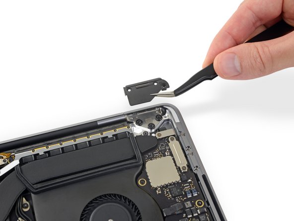

    • Use a T3 Torx driver to remove the two 2.0 mm screws securing each hinge cover (four screws total).
  19. MacBook Pro 15" Touch Bar Late 2016 Screen Replacement: crwdns2935265:019crwdnd2935265:01crwdnd2935265:03crwdne2935265:0 MacBook Pro 15" Touch Bar Late 2016 Screen Replacement: crwdns2935265:019crwdnd2935265:02crwdnd2935265:03crwdne2935265:0 MacBook Pro 15" Touch Bar Late 2016 Screen Replacement: crwdns2935265:019crwdnd2935265:03crwdnd2935265:03crwdne2935265:0
    • Remove both hinge covers.
  20. MacBook Pro 15" Touch Bar Late 2016 Screen Replacement: crwdns2935265:020crwdnd2935265:01crwdnd2935265:02crwdne2935265:0 MacBook Pro 15" Touch Bar Late 2016 Screen Replacement: crwdns2935265:020crwdnd2935265:02crwdnd2935265:02crwdne2935265:0

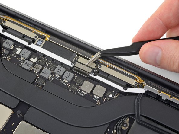

    • Use a T5 Torx driver to remove the single 2.9 mm screw securing the antenna cable bundle.
  21. MacBook Pro 15" Touch Bar Late 2016 Screen Replacement: crwdns2935265:021crwdnd2935265:01crwdnd2935265:03crwdne2935265:0 MacBook Pro 15" Touch Bar Late 2016 Screen Replacement: crwdns2935265:021crwdnd2935265:02crwdnd2935265:03crwdne2935265:0 MacBook Pro 15" Touch Bar Late 2016 Screen Replacement: crwdns2935265:021crwdnd2935265:03crwdnd2935265:03crwdne2935265:0
    • Disconnect all three antenna cables by prying each one straight up from its socket.
    • Slide your tweezers or the flat end of your spudger underneath each cable until it's near the socket, and then gently twist or pry up to disconnect it.
    • To reconnect each cable, align the connector directly over its socket, and then press down so it snaps into place.

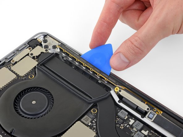

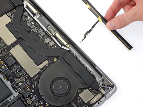

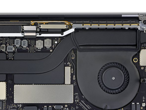

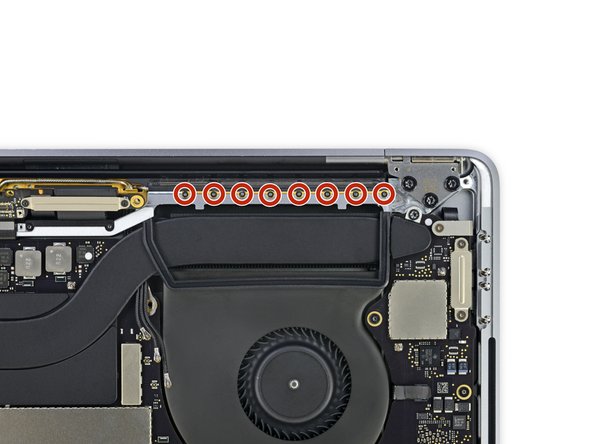

    • Use a P2 Pentalobe driver to remove the sixteen 1.5 mm screws securing the antenna assembly.

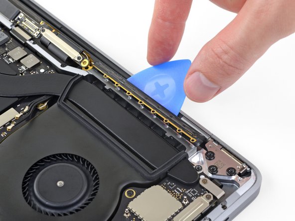

  24. MacBook Pro 15" Touch Bar Late 2016 Screen Replacement: crwdns2935265:024crwdnd2935265:01crwdnd2935265:03crwdne2935265:0 MacBook Pro 15" Touch Bar Late 2016 Screen Replacement: crwdns2935265:024crwdnd2935265:02crwdnd2935265:03crwdne2935265:0 MacBook Pro 15" Touch Bar Late 2016 Screen Replacement: crwdns2935265:024crwdnd2935265:03crwdnd2935265:03crwdne2935265:0
    • Use an opening pick to pry up the antenna assembly and separate it from the MacBook Pro.
    • Watch out for the delicate ribbon cables in the middle section. Avoid sliding the pick from side to side so as not to damage the cables.

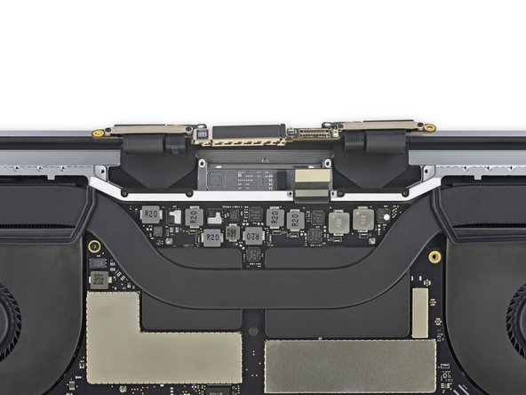

  25. MacBook Pro 15" Touch Bar Late 2016 Screen Replacement: crwdns2935265:025crwdnd2935265:01crwdnd2935265:03crwdne2935265:0 MacBook Pro 15" Touch Bar Late 2016 Screen Replacement: crwdns2935265:025crwdnd2935265:02crwdnd2935265:03crwdne2935265:0 MacBook Pro 15" Touch Bar Late 2016 Screen Replacement: crwdns2935265:025crwdnd2935265:03crwdnd2935265:03crwdne2935265:0
    • Carefully remove the antenna assembly, while simultaneously feeding the antenna cable bundle out from underneath the heat sink.
    • During reassembly, gently pinch the cable bundle together and guide it under the heat pipe into the correct position on the board. If needed, use your tools to help guide it through, but don't force it.
  26. MacBook Pro 15" Touch Bar Late 2016 Screen Replacement: crwdns2935265:026crwdnd2935265:01crwdnd2935265:02crwdne2935265:0 MacBook Pro 15" Touch Bar Late 2016 Screen Replacement: crwdns2935265:026crwdnd2935265:02crwdnd2935265:02crwdne2935265:0

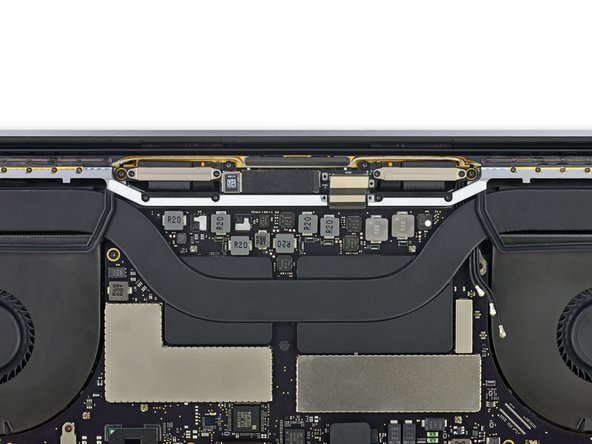

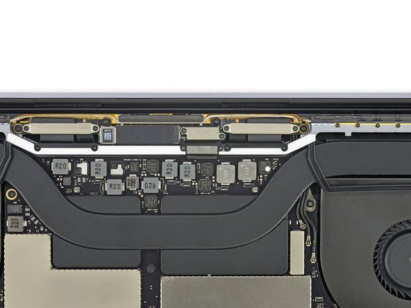

    • Use a T3 Torx driver to remove the four 3.9 mm screws securing the display cable cover springs.
  27. MacBook Pro 15" Touch Bar Late 2016 Screen Replacement: crwdns2935265:027crwdnd2935265:01crwdnd2935265:02crwdne2935265:0 MacBook Pro 15" Touch Bar Late 2016 Screen Replacement: crwdns2935265:027crwdnd2935265:02crwdnd2935265:02crwdne2935265:0

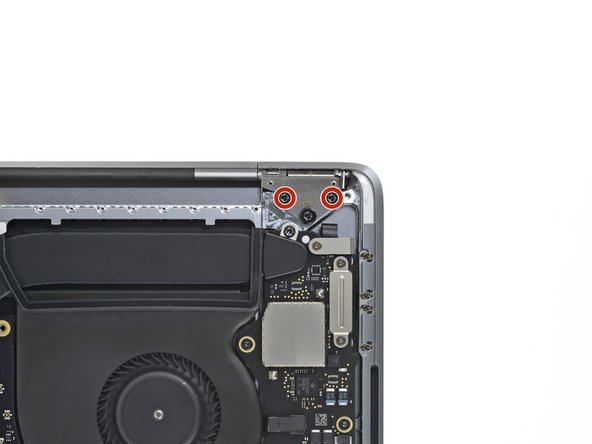

    • Use a T8 Torx driver to remove two 4.9 mm screws from each hinge (four screws total).
    • Each hinge has a third screw, which you should leave in place for now.
  28. MacBook Pro 15" Touch Bar Late 2016 Screen Replacement: crwdns2935265:028crwdnd2935265:01crwdnd2935265:03crwdne2935265:0 MacBook Pro 15" Touch Bar Late 2016 Screen Replacement: crwdns2935265:028crwdnd2935265:02crwdnd2935265:03crwdne2935265:0 MacBook Pro 15" Touch Bar Late 2016 Screen Replacement: crwdns2935265:028crwdnd2935265:03crwdnd2935265:03crwdne2935265:0
    • During reassembly, first install the hinge screws without tightening them. Then adjust the screen until it is correctly centered and aligned on each side. Finally, tighten the screws.
    • If your screen clicks or snaps upon opening, loosen the hinge screws and adjust the alignment. Make sure the screen doesn't sit too far forward, or it can catch on the body when opening and closing.
    • If desired, add a little blue threadlocker to the screw threads to prevent them from loosening over time.
