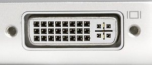

What do you see when you connect your system to an external display?
Your system has an older video standard DVI.
You likely will need an adapter like this one: StarTech.com DVI to VGA Cable Adapter - Male DVI to Female VGA so you can plug in your VGA monitor. If you have something else you’ll need a different adapter/
Hi Dan, thanks for the quick response. I did know that I had to get an external monitor to check, but at the time I had neither monitor nor cable to connect to my tv. I was hoping that someone had seen this sort of thing before. I now have a cable and I see the same on the tv as I see on the laptop so I know it is the graphics chip which I believe is part of the motherboard, is that not so?
Sadly yes ;-{
Your GPU has failed, time to get a replacement system.
