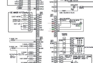

Can’t see it to well from your image but did you measure the sensor out of circuit i.e. disconnected from where it plugs into the connector at the back and measured directly across the sensor wires themselves, not at the plug point still plugged in? Hopefully this makes sense ;-)
The reason is that as can be seen from the wiring diagram (see below) the sensor is in parallel with some other sensors and if measured with it still connected the reading on the meter wouldn’t be accurate.
If you didn’t measure it when disconnected, unplug the sensor and measure directly across the two sensor wires at their plug and not at the socket that it plugs into. That way you are looking only at the sensor with the meter. Try not to touch the sensor itself with your fingers as this will start to warm the sensor and alter the reading.
If you did measure it out of circuit and the reading was 7.5 Ohms then this indicates a temp of appprox. 15C
(click on image to enlarge for better viewing)
The fact that the sensors are all connected would be taken into account when the circuit was designed so as to give an accurate display but would still rely on the fact that the sensor has to give the correct resistance reading at the specified temperatures whether it was connected as it is or as a standalone sensor.

If the fan doesn’t operate at all here’s an image of the operate circuit from the control board. Disconnect the power from the fridge and then disconnect the cable on the board and test between pins 4 & 8 on the cable and also between pin 7 and the fan motor itself, should be a red wire on the fan. I don’t know what the resistance between 4 & 8 will be but it won’t be open circuit. I think that the red wire may be the fan sensor wire but I may be wrong. Anyway there should be a connection from the board to the fan on all 3 wires, and the fan motor should be between 2 of the 3 wires
The above is just trying to eliminate another possibility, so if the freezer evap fan is OK and since you have checked the freezer temperature thermistor circuit back to the control board and it is OK, that only leaves the control board OR perhaps a sealed system problem i.e. a compressor problem or a lack of refrigerant due to a leak. Low refrigerant levels can mean that the refrigerator gets cold enough but not the freezer. Check for any oily residues on the condenser coils or under the compressor. There is a special lubricating oil mixed in with the refrigerant to help lubricate the compressor. If there is a leak anywhere, the refrigerant will escape to the air undetected but the oil will leave a trace.
You can either replace the control board (find a supplier with a good returns policy if it turns out not to be the board) and if it isn’t the board then the high/low pressures in the sealed system will need to be checked. Depending on your location, this most probably will have to be done by a licensed refrigerator repairer, due to the regulations regarding the handling of refrigerant gases that apply in a lot of places.

Use the Ohmmeter to test for continuity from the sensor harness wire where it plugs into the connector at the back and the yellow wire on CN30 connector pin 3 on the control board. Also check that the other wire for the sensor connects to earth or to grey wire CN30 connector pin 9 on the control board.
Test with the power disconnected at the wall outlet
Something is wrong with the information from the freezer sensor. The sensor tests OK for the given temperature yet the control shows the incorrect temperature so you have to prove both the sensor wires from the sensor wiring harness connector to the control board and if they're both OK it must be in the control board
Hello, I don't understand how to find corresponding connectors (pin 3 and pin 9). I looked into the document HM09 SM, but there are a lot of diagrams, so I don't know which one, and then I don't know how to localise those pins.
Is that the sensor part by PCB, numbered 7 on the page 79? The pins 3 and 9 of that connector?
@katkacyt
look at p.80 Connector Layout & Description (Main Board) the orange block of connector information on the right side of the board (actually at the top of the image in the manual). pin 3 says F-SENSOR and pin 9 says GND.
Unplug the cable and measure between 3 & 9 on the cable not on the board. You should measure the sensor resistance. If you know roughly what the temperature is then the sensor's resistance should be as shown for the temperature in the table I posted above in my answer.
