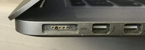

Let’s also look at the MagSafe port is it clean and the pins the same gold color?
I hope your’s doesn’t look like this ;-}
I often see people who bought knockoff chargers damage their systems either at the MagSafe port or internally the charging logic gets damaged. Is thins the original charger or did you replace it? Did you get a REAL Apple unit directly from Apple of something else?
Update (10/02/2020)
Oh Boy! The MagSafe cable’s magnets are stuck to your systems MagSafe connector! These magnets look like a knockoff’s charger not the original Apple design which uses a single magnet Vs four units you clearly have here:
If you can’t get them out you’ll need to replace the MagSafe DC-In board MacBook Pro 13" Unibody Mid 2012 MagSafe DC-In Board Replacement iFixit is out of stock presently MacBook Pro Unibody 13" and 15" MagSafe DC-In Board, even still take a look at the part to see part rotate it around so you see a side profile, note the connectors pin part is raised above the base and the base has a grey plastic plate.

@tommyboy_818 - Wow your MagSafe connecter is almost black with junk! Time to get a pile of cotton swabs and isopropyl alcohol. to clean the black stuff out!
Post a new pic so we can see if after you've cleaned it up
Hi Dan, I will certainly clean the MagSafe connector but the Macbook still goes to sleep irrespective of it being on charge
@tommyboy_818 - The PPT004 error is telling me the MagSafe connection is having issues which we need to fix first. Then we can reset the SMC to clear the bad charge data it currently holds. This should fix your running on battery issue.

@petercoffin80 - The problem is these odd magnets are interfering with the good MagSafe charger from mating! So without removing them to make space for the MagSafe cable connector the system is not able to be charged.
