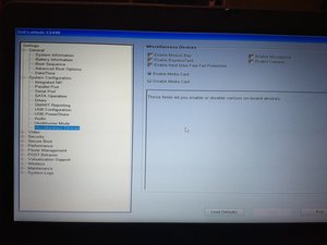

The camera typically doesn’t require a special driver - it’s either a bad BIOS setting or a camera/display cable issue where everything works but the camera. Start with the camera module and if that doesn’t work, you’ll need to change the LCD cable. In this case, the camera module is less invasive of a swap then the LCD cable.
If you don’t see the camera, you can check the BIOS and see if it’s enabled - if it is, then it’s typically a hardware issue with the camera itself rather then a Windows driver issue.

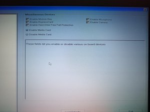

You want to see if this setting is enabled in the BIOS correctly:
Hi @nick ,
Thanks for the image verifying that there is a camera setting in BIOS.
I couldn't find anything online regarding this and the manuals don't mention any of the BIOS settings specifically.
Cheers
@jayeff That's on my E6440, but yes Dell does have a BIOS camera setting on the overwhelming majority of their laptops. On the Dell BIOS it's typically under miscallanious devices. Yes I did leave Free Fall protection on with an SSD installed but that's because I had to reset the BIOS defaults when I got it since I purchased it used and didn't know what it was set up for. I don't think the driver is installed.
