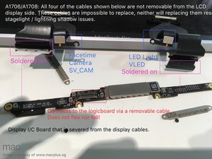

I doubt you have a driver issue, more likely the cable to the lid failed. Apple had a fair amount of failures of the backlight cable 2018 MacBook Pros Try to Solve Flexgate Without Admitting It Exists while the cable here is not the same cable it is exactly the same mirrored on the other side (Blue marked)
Your the second person who encountered I know of that experienced this failure.
Sadly its time for a new display assembly, Ouch!

If the Right backlight cable is exactly the same as the Left FaceTime cable in length and design would it be so far for the same problem to happen with it?
As I stated (I thought clearly) you'll be the second person which encountered a failed camera cable! Due to the exact same issue as the backlight cable!

After inspecting the display cables, I see that the Facetime Camera is clearly broken while the LED light cable is not.
Thanks to your comment I was able to identify the problem. Thank you, Dan!

My story ends by replacing the wire from motherboard to screen. I have the photo of my problem but can’t attach to this message
Problem was the broken wires from motherboard to the screen, my friend fixed it without screen replacement.
