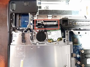

WARNING: ON THE E6X40 SERIES, there are TWO display types - LVDS and iDP and they go to the following configurations:
  • LVDS: Intel HD
  • iDP: Radeon 86/8790M+Intel HD
    • Note: Some Intel HD E6X40’s use the iDP display as well - check to be sure.
Since it’s a known issue on the E6 series, I would strongly advise checking the service tag for any clues of the iDP panel and making sure you know which connector goes to each type. See this for an example of that the iDP machines show up on the Dell system configuration to get an idea of what to look for:
It’s especially important to know if you look for a bare replacement display but say, you find the entire assembly for not much more and it may potentially have a higher resolution panel or be in better shape cosmetically. The sellers never seem to know, so go with your gut and check the connector in the photos.
As another aide to spot the difference, I have attached a photo of the more common LVDS board connection so you can quickly identify it from the iDP version when you check the connector type:
If you want to see the iDP connector, I have one I can use for it.
