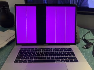

Yesterday the screen on my 2018 MacBook Pro 13” with the touch bar turned purple. It still works if you only open it up about 25 degrees. We talked to Apple and they offered to replace the screen for $475. Any other options? Is this part of the flexgate issue?

@Agnes Xie - Sadly the displays T-CON board has a problem. You might want to see if Apple will cover it as an extended warranty as Apple had a bad run of displays that exhibited this problem. Given how long its been they may not fix it for free and a new display is not cheap ;-{

This is now the third system posted here which noted the angle altered the screens display Vs backlight. I’m not sure if its the same short cable issue discovered with the 2016 models backlight issue.
It’s possible the issue is still within the T-CON board where the cables connect to from the LCD panel. The black plastic clutch cover which covers the area might not offer enough protection from a bang. Which while a weakness is not at the level of a recall.
Sadly, you’ll need a new display assembly to fix this.

My wife’s machine has the purple death as well. But it only came back to life a few times at unpredictable angles.
Apple online chat said ‘take it to an authorized repair’. An hour trip to Ipswich UK to find out they quoted at £600 (roughly $800) to replace the whole display after looking at it for ten seconds.
