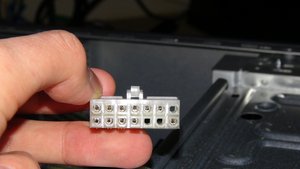

I’m pretty sure they picked that power supply on a very specific holiday with how bad of a choice it was :P. Even HP put it down for the p7 even though it’s almost as bad, but it’s a 260/300W unit lacking PCIe 12V. Dell was also smoking something with their 460W unit in some of the older XPS machines, but it has the PCIe 12V provisions on it at least. However, it’s probably only there because of the GPU options requiring it on some cards and it was too much to spin one without it. Even if it’s there, it’s not good for much - if you have the i7 3770 version of the XPS 8500 with this power supply and want a better GPU then the factory options, it needs to be replaced since there isn’t enough headroom left. It’s only good for a few low power cards that exceed the 75W PCIE slot limit or you need to replace it.
These low wattage supplies always burn out within a few years because they can’t take the stress they’re under for more then 2-3 years on average. That said, you may get lucky and run the original unit for 4-5 years, but that is rare. Usually these low wattage units use the 14-pin Lenovo supply that doesn’t comply to any ATX standard, especially since Ivy Brige or Haswell Celeron/i3 SKUs. It probably also weighs nothing, so I bet there’s an issue with the caps or stressed VRM modules due to the load. Repair isn’t worth it, sadly. Even if it was, these are stressed hard so you’d need to go over EVERYTHING and do a complete inspection.
Your machine uses the nonstandard Lenovo 14-pin - it’s a Celeron or i3 gutless wonder from the factory! :-(. From the limited research I have done, it looks like Lenovo took one of Dell’s dumb ideas from the early 2000’s with the PIII and early P4 s478 desktops with a standard 20-pin, but with a modified pinout. Even though it can be done with a SFF unit (PITA to find good ones 3rd party), this is to ensure Lenovo gets the sale and you’re locked into their crap units! Shame on you Lenovo for this decision!
It’s likely going to be an AcBell or an FSP Group unit (possibly a OEM Delta), so it’s not terrible but it is never going to be as good as a quality Seasonic retail unit. What makes this insulting is if this had a higher end CPU in it like the i7 with a full fat TDP rating (read: Not the S spec CPU), it would need to use the standard 24-pin connector to survive the load!

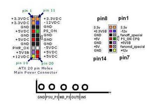

24-pin vs 14-pin (Standard)

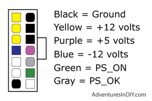

Lenovo “standard”
Hi @nick ,
Just curious as to where the -5V is on the Lenovo power supply as mentioned by the OP but not shown on your Lenovo "standard" wiring diagram?
Presumably one of the "white" connectors.
Cheers
@jayeff Maybe - I don't have one of these sorry excuses of a power supply to find it. I'm thinking it's being generated from a VRM dedicated to the conversion in the nonstandard supply or it's being done with the +5V rail as a piggyback rail.
-5V is rarely used these days, but it's in the spec even up to 2.01 but is not present in the 2.2 revision, so Lenovo added it back. While it's there, the Lenovo connector doesn't follow any standards so anything goes. After the semi modern ATX machines, it practially became obsolete. It was primarily an AT thing.
@nick I see. Custom connector. I thought only DELL did that a number of years ago!?!?
@aactech They smoked whatever inspired Dell on the PIII and early s478 machines... They clearly wanted to go the extra mile to ensure that power supplies are nonstandard (despite being limited by the TFX spec anyway!) but all this stuff does is unite us on it being unacceptable. I looked at a thread on the Lenovo forum and people said they were going to Dell because of it.
For me those old Dell systems in question aren't worth messing with unless it's free or it comes with the newer system I don't want them anymore... Not just because of the power supply mess but because they're just not worth it anymore in a sea of cheap Core 2/Core i Sandy/Ivy machines and similarly aged AMD machines.
Supposedly adapters exist, but these are TFX units and you're pretty limited beyond 250W - I've seen 300W ones, but I don't know if they ever made 350W work on the TFX standard. Make sure the pinout is right unless you want to fry the board.
