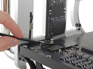

Since the Apple stores are closed, it may be a case where you need the riser board that’s screwed into the case. I’ll work on the APN but that’s what the part looks like, but for now I’m stuck since nothing has leaked on this one yet.

Still having trouble finding it, so you may need to get a case if it's part of the case assembly. I would see if reconnecting them helps, but don't tell Apple you tried.
I'd love to see a system report of a similar Mac Pro so I know what it should look like. I don't have a baseline.
I might try reseating that riser, maybe it was dislodged during shipment.
