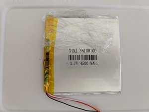

It is about 3.9” by 3.9” (100 mm by 100 mm and 3mm thick) with a small circuit board on one edge with black, red and white (smaller gauge) wires connecting to the mother board of the tablet.
I purchased a battery with the similar dimensions and electrical specifications on ebay.
The tape holding the old battery was removed and the old battery was carefully pried away from the double side sticky tape holding it in place. The wire soldered connections were melted to break the connections and finish removing the old battery. The new battery was taped into the tablet and the wires from the new power management board were soldered to tablet contacts to match the original wire color locations.
