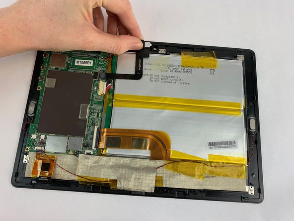

    • Turn the device screen side down.
    • Carefully remove the back piece with the iFixit opening tool.
  2. NuVision 10.1 Atom Glass Screen Replacement: crwdns2935265:02crwdnd2935265:01crwdnd2935265:01crwdne2935265:0
    • Remove the yellow tape covering the motherboard gently with your fingers.
  3. NuVision 10.1 Atom Glass Screen Replacement: crwdns2935265:03crwdnd2935265:01crwdnd2935265:03crwdne2935265:0 NuVision 10.1 Atom Glass Screen Replacement: crwdns2935265:03crwdnd2935265:02crwdnd2935265:03crwdne2935265:0 NuVision 10.1 Atom Glass Screen Replacement: crwdns2935265:03crwdnd2935265:03crwdnd2935265:03crwdne2935265:0
    • Pull the camera plug upward and away from the motherboard with your fingers.
    • Gently pull the camera from the device. The camera is held by tension.

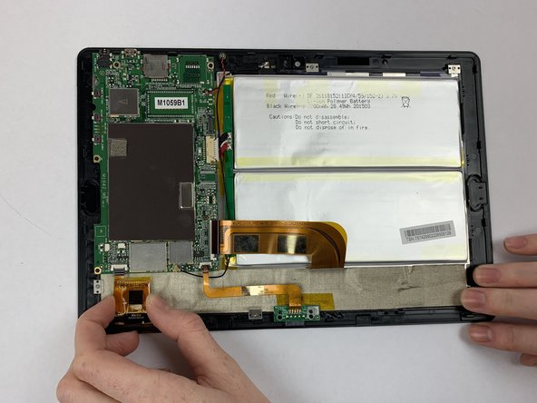

  4. NuVision 10.1 Atom Glass Screen Replacement, Speaker: crwdns2935265:04crwdnd2935265:01crwdnd2935265:01crwdne2935265:0
    • Carefully remove silver tape with your fingers.

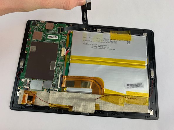

  5. NuVision 10.1 Atom Glass Screen Replacement: crwdns2935265:05crwdnd2935265:01crwdnd2935265:02crwdne2935265:0 NuVision 10.1 Atom Glass Screen Replacement: crwdns2935265:05crwdnd2935265:02crwdnd2935265:02crwdne2935265:0
    • Remove speakers gently using your fingers, they pop out easily.
    • Disconnect cords attached to the speaker from white pod.

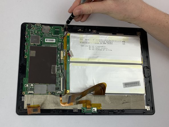

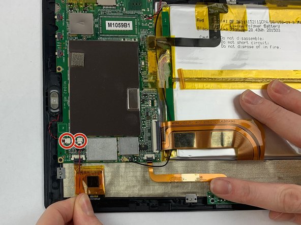

  6. NuVision 10.1 Atom Glass Screen Replacement, Motherboard: crwdns2935265:06crwdnd2935265:01crwdnd2935265:01crwdne2935265:0
    • Disconnect the press-fit black and red curly wire from where it connects on the motherboard.

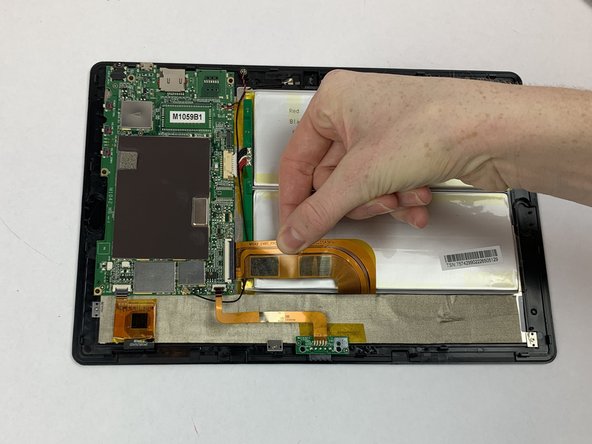

  7. NuVision 10.1 Atom Glass Screen Replacement: crwdns2935265:07crwdnd2935265:01crwdnd2935265:03crwdne2935265:0 NuVision 10.1 Atom Glass Screen Replacement: crwdns2935265:07crwdnd2935265:02crwdnd2935265:03crwdne2935265:0 NuVision 10.1 Atom Glass Screen Replacement: crwdns2935265:07crwdnd2935265:03crwdnd2935265:03crwdne2935265:0
    • Gently remove the battery's three ZIF connectors from the motherboard. Use your fingers.
    • Be careful not to puncture the battery.

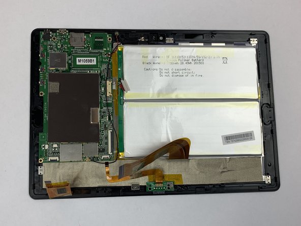

  8. NuVision 10.1 Atom Glass Screen Replacement: crwdns2935265:08crwdnd2935265:01crwdnd2935265:02crwdne2935265:0 NuVision 10.1 Atom Glass Screen Replacement: crwdns2935265:08crwdnd2935265:02crwdnd2935265:02crwdne2935265:0
    • Disconnect the battery's bundled cable connector from the motherboard with fingers.
  9. NuVision 10.1 Atom Glass Screen Replacement: crwdns2935265:09crwdnd2935265:01crwdnd2935265:03crwdne2935265:0 NuVision 10.1 Atom Glass Screen Replacement: crwdns2935265:09crwdnd2935265:02crwdnd2935265:03crwdne2935265:0 NuVision 10.1 Atom Glass Screen Replacement: crwdns2935265:09crwdnd2935265:03crwdnd2935265:03crwdne2935265:0

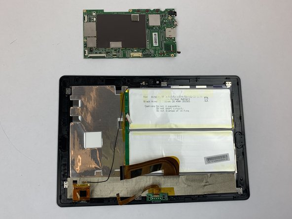

    • Remove the four black 3.32mm screws on the corners of the motherboard using the Phillips #000 screwdriver. The motherboard should come out easily.

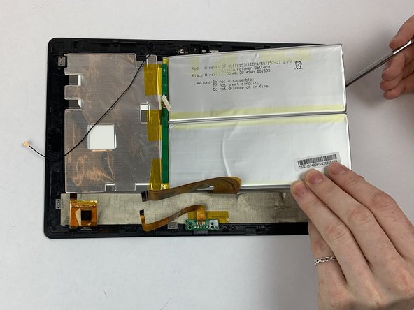

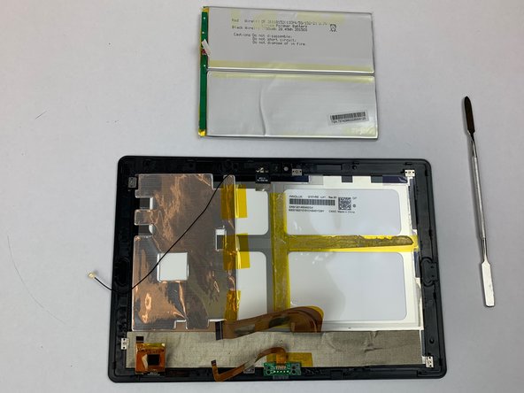

  10. NuVision 10.1 Atom Glass Screen Replacement, Battery: crwdns2935265:010crwdnd2935265:01crwdnd2935265:03crwdne2935265:0 NuVision 10.1 Atom Glass Screen Replacement, Battery: crwdns2935265:010crwdnd2935265:02crwdnd2935265:03crwdne2935265:0 NuVision 10.1 Atom Glass Screen Replacement, Battery: crwdns2935265:010crwdnd2935265:03crwdnd2935265:03crwdne2935265:0
    • Pry the battery away from the display screen gently using a nylon spudger or the plastic opening tools.
    • Using a metal spudger may bend or puncture the battery. Lithium batteries are prone to explode.
    • There is a lot of adhesive, take your time and be careful.

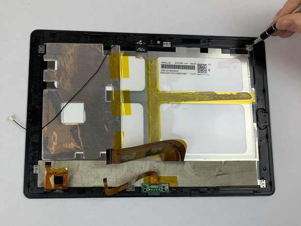

  11. NuVision 10.1 Atom Glass Screen Replacement, Glass Screen: crwdns2935265:011crwdnd2935265:01crwdnd2935265:02crwdne2935265:0 NuVision 10.1 Atom Glass Screen Replacement, Glass Screen: crwdns2935265:011crwdnd2935265:02crwdnd2935265:02crwdne2935265:0
    • Remove six silver 2.8mm screws surrounding the battery using the Phillips #000 screwdriver.

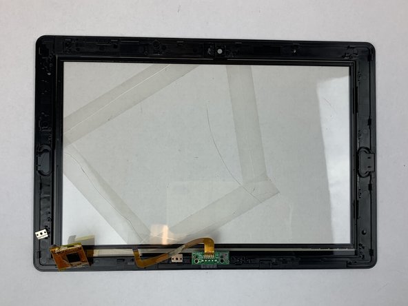

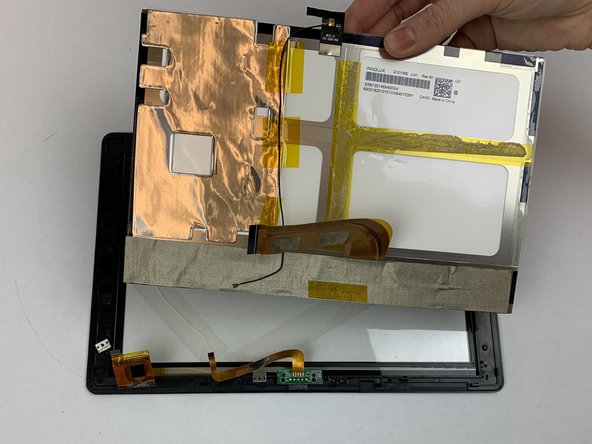

  12. NuVision 10.1 Atom Glass Screen Replacement: crwdns2935265:012crwdnd2935265:01crwdnd2935265:03crwdne2935265:0 NuVision 10.1 Atom Glass Screen Replacement: crwdns2935265:012crwdnd2935265:02crwdnd2935265:03crwdne2935265:0 NuVision 10.1 Atom Glass Screen Replacement: crwdns2935265:012crwdnd2935265:03crwdnd2935265:03crwdne2935265:0
    • Remove tape securing the camera to the device gently using your fingers.
    • Pry display screen away from screen glass gently using your fingers.
