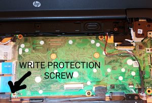

Anyone know where the write protect screw is?
Hi Waseem Azma
Suggest you to follow the guide and teardown to the mainboard section
HP Chromebook 14-ca061dx Motherboard Replacement
Im not sure .. but if you observe on step 13.... there is a missing screw at the bottom right of it. check and compare with yours.
out screw protector
Young aspiring engineer - i have two images attached that will show you what your looking for. Apologies on the quality of the images I’m 55 and a little cranky. This system belongs to a friend of mine and believe his son may of got carried away with the handling of the motherboard
