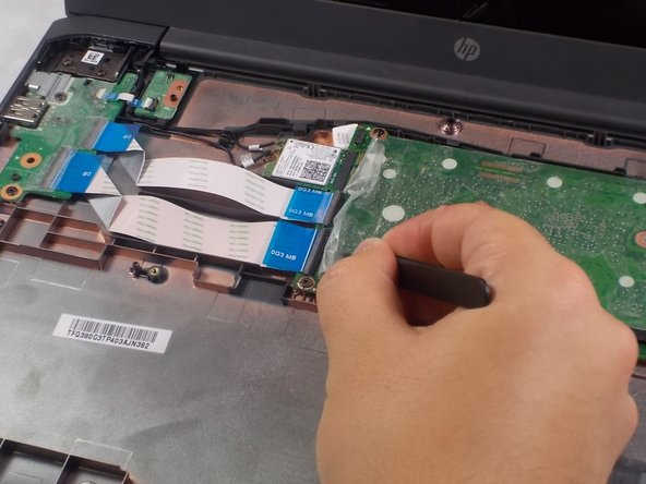

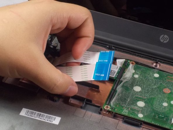

    • Pull back the plastic covering of the cables connecting the motherboard to the daughter-board using tweezers.
    • Flip up both of the black plastic pieces using the spudger.
    • Remove both of the blue and white cables by pulling the blue plastic pieces toward you.
    • Disconnect the cables carefully because they are fragile.

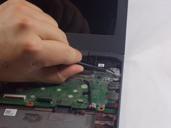

    • Peel back the plastic covering on the wires connecting the screen to the motherboard using tweezers.
    • Peel back the black electrical tape using tweezers.
    • Remove the wires by pulling the plastic piece away from you.
    • Make sure to pull the plastic piece and not the wires because the wires are fragile.

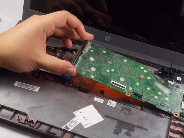

  15. HP Chromebook 14-ca061dx Motherboard Replacement: crwdns2935265:015crwdnd2935265:01crwdnd2935265:02crwdne2935265:0 HP Chromebook 14-ca061dx Motherboard Replacement: crwdns2935265:015crwdnd2935265:02crwdnd2935265:02crwdne2935265:0
    • Remove the four, 4 mm screws from the motherboard using a PH0 head.
    • Remove the motherboard from the Chromebook.
