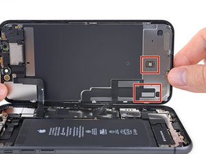

Hey guys I’m wondering since Apple has locked the iPhone 11’s and they won’t take any 3rd party screens Is anyone worried about that? Has anyone tried to apply for the Apple certification repair store? And if so, how has the process been? And if you have any advice about it? Or have anyone replaced an iphone 11 screen with a 3rd party one yet? I just got the qianLi icopy thing it works amazing. I wonder if we would need to used a device like icopy to remove the iphone 11 screen warning.
The phone knows the screen is a replacement by one of these chips (likely the QR engraved one), but in the past that hasn’t stopped FaceID from working as long as the paired sensor isn’t swapped. If you swapped the sensor, put the old one back into the phone and see if that helps. The issue is the data for the phone on the secure enclave does not match the blank screen - the current tools Apple uses are cloud based, so it isn’t like ASD on older hardware where a leak was worth something.
If the sensor is unchanged, you’re probably better off going to an authorized IRP shop instead of Apple, especially since you opened the phone and they may turn you away for making a repair attempt - whereas an IRP authorized shop will probably look the other way since you’re not the first one to try it and go back to the stock screen, and return the 3rd party one.
Yes you are right. it's all about the touch module here. Transplant the chip onto the replacement screen and the problem is fixed. iPhone 11 Series Non-Genuine Screen Warning/Important Display Message - 100% Fix

I’ve recently swapped an 11 pro max display with an original display pulled out of another 11 pro max.
everything works 100% including true tone (copied the display serial numbers via one of the programmers available online). However, the display message is there.
In contrast, I swapped the display on another 11 pro max with a third party oled display. This one showed up absolutely no serial numbers on the display programmer which indicated that the IC on the display was “blank”. After restoring the display serial numbers on this 11 pro max’s display, all the notifications were gone however this display does not support true tone. The option is not there in the menu. Weird but verified.
