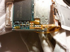

I just took my iPod 4th gen apart and there was corrosion on the board so I figured I may as well clean it. Will update when I see what happens!
