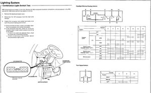

Looking for some help it’s a 95 accord lx 2.2 automatic and I could really use some help not very car savvy but I’m willing to learn so please be detailed and thank you in advance but yeah I replaced the bulb on the signal next to the headlight and the one on the bumper “looks” fine what next?

Here are two images that may help.
The first is the circuit diagram for the lights and the second is how to test the combination light /turn signal switch to check if it is OK.
(click on images to enlarge for better viewing)
