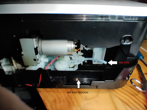

I have a Canon Pixma Mg3120 ( picked the closest printer I could ). I am getting an error code E08 on my printer. Pressing Black copy lets me print. I would like to remove the ink blotter. I’m confused where the pad is located.
I located the hard pads on the ink cartridge resting place. I have pulled them out and cleaned them. I have not put these pads back. I notice what look like drain holes below these pads. I suspect that there are larger blotters in the printer. Where are they? How do I get to them?

Pull the side panel off of the printer where the service station is to gain access the major pad. However, you will need to do a complete disassembly and check all of the pads to prevent it from overflowing. There’s a pad on the platen, and in the base as well.

In a Pixma MG3550 the main pads are in a trough just inside the right-side cover, as Nick says.
The ink is pumped to the pads through the pipe, which has to be pulled off to remove the pads. Then two clips must be unclipped to remove the cover from the pads, which will bring some pads with it and leave some in the trough.
