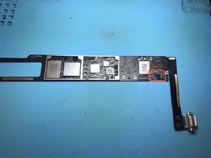

Anyone know what part I can use as replacement?

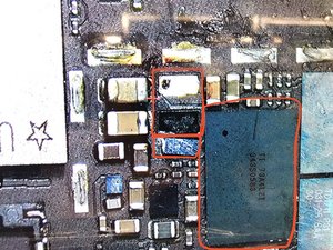

Something overheated when the display broke and I was wondering if anyone know what parts from another ipad I can use to substitute the parts. I am looking for a coil, diode and touch IC.
diode says: 10F40 Y16
touch IC: should be the same as ipad air 2
coil: can’t seem to find the same size on the ipad air.
Have u checked schematics? There u will get values of parts and then use your donor boards schematics to find a match, as the size is not always the case
Schematic is the problem, neither zxw or wxz shows parts, it’s an empty board view.
