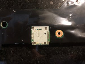

Can this be repaired SIM card circuitry
https://ibb.co/rbTXjCn
https://ibb.co/yNt75LZ
https://ibb.co/xmr3GSf
I inserted a wrong misfit sim card tray into my Thinkpad T440. The tray engaged into interlocked i could not pull out. After I pull out with a certain amount of force, I pulled out the sim card tray and along the above gold metals. I feel really stupid. Can this be repaired?

The SIM card reader is mounted on the systemboard.
To gain access to the SIM reader you’ll need to remove the systemboard.
Here’s a link to the hardware maintenance manual for your laptop, taken from this webpage (select p.2 at bottom of list and then scroll down to find the entry)
Scroll to p.86 to view the necessary pre-requisite steps and then the procedure to remove the systemboard.
That was the easy part.
Once you have access to the reader you’ll have to determine what type and configuration of SIM reader was used and then try to find a compatible replacement part. (I cannot find any information, part numbers, brand name etc, as to what type was used)
Once you have the part you’ll need SMD (surface mounted device) soldering tools and skills to effect the repair.
Perhaps it may be easier to take the laptop to an authorized Lenovo service repair centre and ask for a quote to replace the SIM card reader. They may have access to more information regarding the SIM reader etc and also the necessary tools and expertise to perform the repair.
You may be able to lower the cost of the repair by taking just the systemboard, thereby reducing the labour cost by reducing the amount of time that the repairer spends in dis-assembly and re-assembly of the laptop. The downside of this is that the repairer can’t test the repair and ensure that you have a fully working laptop upon completion and perhaps will offer no guarantee.
If you can solder, then you could try to fix the contacts.

I have the similar problem - I bought a T440p with a messed up sim card slot. It looked terrible, I decided to remove everything….but I wonder what I could replace it with now.
@jayeff: Do you have an idea which (maybe non-Lenovo) part could be soldered here?
Hi,
I'm fairly sure that a non Lenovo SIM reader port could be used but the hard part is knowing which SIM card reader -examples only would be compatible with the motherboard.
Factors to take into account would be the reader's mounting lug position to that of the pads provided on the motherboard.
The pitch of the reader's pins i.e. distance apart so that they match the motherboard.
The type of SIM Card reader, Standard, Mini or Micro.
Do you still have the old reader and are there any markings on it which may identify the manufacturer of the component? This may help as perhaps you could search their website for a suitable replacement.
Also try searching for the motherboard service manual i.e search for "(insert motherboard 'board number") schematics or manual" etc, sometimes these types of manuals contain a parts list which may be of some help.
I did try looking for "faulty" motherboards for your model and thought if the price was OK and they had a SIM reader shown in the image that it may be worth the gamble to get one as a "donor" board for the part but most all that I found showed no reader port in the image posted. The gamble being of course that the reader was OK as the owner might not have used it. Just an option to consider if you're having trouble locating a replacement.
That's all that I can think of at the moment.
Thanks for your reply - I ordered a faulty board and will see how the intact sim card socket looks like. Most likely I will destroy it while removing it, though. Some parts of the socket on my board were really sticky even after heating it up, maybe it's impossible to remove it without deformation/partly destruction from the faulty board. But at least I will know how the intact socket will look like - maybe I find it on Mouser or elsewhere)

Thanks - there is WiFi almost everywhere nowadays, mobile hotspots, etc. Surely, there is no need to fix it, but rather the challenge to get it done.
Also, there are PCI adaptor cards with slots for a WWAN card AND a sim card socket as a workaround for T430, etc., but I could not find any such adaptor+sim card socket for M.2/T440p.
I'll guess I'll just try to find a similar-looking sim card socket after I inspected the faulty mainboard I ordered - and hope I will get it soldered at the right spot)

I fixed one myself using an heat gun and soldering iron, hard part is stripping the laptop then removing the metal cage around the sim card tray, the gold contacts are easy enough to solder on and off, i looked at many old phone sim card contacts to find a useable replacment , i broke off 3 and fixed mine. just hope you havent broken the contacts and need to make tracers to the pads pulled off,
If youre lucky its just a pin like this https://youtu.be/UW80B6OXdpg
Any phone sim card contacts will work : example of whats needed here https://youtu.be/zF2IoWP_vg0
