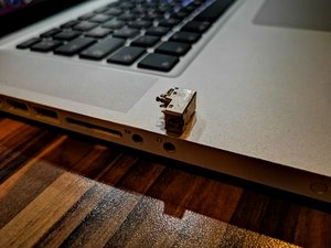

Your digital audio out has switched on. You can insert a plastic toothpick in the hole and try and switch it off. The switch should be at the 3 o'clock position and go towards the 6 o'clock position. Some people also have had luck inserting their headphone jack and pulling out a few times. Another recent report was that inserting the headphone jack and turning it in the hole helped.

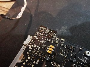

And if those solutions don't work, fear not ... all you have to do is replace the logic board!
I've tried that but i read about a something with a software where you can choose different outputs. I think the switch in my headphone jack is broken because i excerpted a little bit of force last time i tried it.
I don't know about a software fix. If you're frustrated with trying to fix it, get a new pair of eyes and hands to read how to fix it and give it a shot. I have never heard of anyone actually breaking this switch.

put your mouth directly on the port and blow as hard as you can while the mac is on. Trust me it works. I struggled for hours before i knew it actually works. It is worth the few seconds. Cheers.

This worked perfect for me. I was struggling, trying to find a way to fix it, until i found this, thank you. Ignore other complicated solutions. No toothpick needed.
thank you very much for this idea,worked perfectly.
Blowing in it worked!!!!!
Holy crap, I was an apple certified tech for half a decade, and I'd never heard of this. Totally worked on a Mid 2012 Unibody MBP.
Boom! worked first try.
