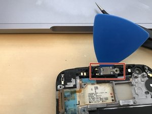

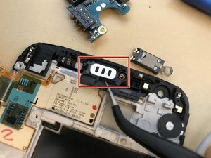

After dropping my phone it still worked perfectly except for cracks across the screen. I replaced the screen. Now I don’t get any sound when answering the phone. However it works with the speaker phone on. What did I do wrong
Hello
Do people at the other side of the call hear you
If they do
I be looking at the earpiece of the phone
It possible you may have damaged it or installed it incorrectly
See the images
Let us know how you get on

Thanks for your response with pictures. It showed me that I had missed transferring the ear piece casing from the old screen to the new screen. Now I can hear the other party during a call without turning on the speaker phone. I had followed a number of YouTube videos, but none of them showed the ear piece casing. I guess there are variations of the LG-5 phones. Incidentally, I also had to transfer two pieces of rubber spacers from either side of the ear piece speaker from the old screen to the new screen to make the camera flash light and the proximity sensor work. Without that I was getting the phone screen to go blank during a call.
