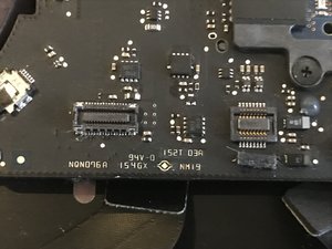

This morning I started looking for the board number so I could check if it needed a 220 or 330u Cap when I noticed this damage to small IC on it :/
At this point i'm beginning to think that i'm flogging a dead horse, I don't know what that IC does, but there's at least ripped track, Is this time to give up?? or can I get this machine working again, I really need some encouragement right about now.

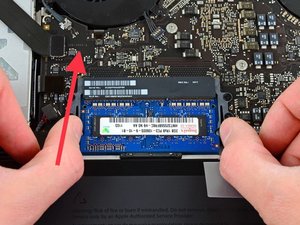

Whats your board model number?
I'm still trying to figure that out, Serial C02HQ0YRDV7P, MLB C02217400VLDYMGA7, EMC 2563
The model number for the board is engrave if you take a picture of the whole board I can spot it for you.
Nice one, Both sides?
Never mind is next to the dvd drive flex cable you will see numbers starting 820-
Since you have a 2011 board it’s useless to go further into looking at the C9560, it doesn’t apply to your Mac, it’s a known issue of the 820-2850 of previous series. Unless you’ve attempted to fix something yourself, I wouldn’t be overly concerned about that mosfet and the misplaced resistor in pictures for themselves but they might be an indication someone already put his hands on that board before. Being a 820-2915 I wouldn’t be surprised somebody temporarily “fixed” the faulty GPU that plagues your series by “baking” the board.
Symptoms unfortunately point to a faulty GPU, which is pretty common on those Macs. You can find on the internet several ways to disable the discreet card (hardware, software and hybrid) and use the Macbook with just the integrated Intel HD 3000.. dive into some threads around and pick your own choice.

see it here
This is what I have
820-2915-B, %#*@, that's hidden well!
This Component is Q4260 is a Firewire Port Power Switch the pad thats broken leads to Nowhere. Have you tried to make sure you hard drive boots on another macbook ? Make sure it reads tru another computer?
Yep, the drive boots perfectly on my wife's MBP using a USB-SATA adapter.
