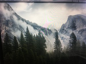

Whenever i turn my laptop on, after using for 15-20mins/ half an hour the horizontal line on the top of the display showed itself, and vibrate continuously. It get bigger in width slowly.
if i put it to sleep for 5mins and open again, everything look likes okey. but after around 15mins again that line blow up
help me if there is any solution. isn’t there any solution without replacing display?

The cause is over-heating. Blocking the vents by using the system on a bed or other cloth surface which the system sinks into. Heavy online gaming which is very heavy with graphics. And lastly, heavy image or video editing.
I've had to replace over ten displays across the entire line. We have over 20 posts here alone of people encountering this issue.
How can it be over heading when an external montor works on it with no lines
The T-CON board is part of the internal display it has no involvement with the external display ability to display.
If I break (crack) the internal display screen that won't impact the external display will it. You are trying to rationalize displays A issues as impacting display B you just can't here.

Sadly this is a known issue in the newer MacBook Pro’s! The TCON board overheats so the components loose their values so the scan gets messed up.
You need a new display assembly to fix this MacBook Pro 13" Retina (Late 2016-2017) Display Assembly and heres the guide MacBook Pro 13" Function Keys 2017 Display Assembly Replacement

but isn't same problem happen with the newly replaced display?no problem with new display's Tcon board ?
I'm not sure I follow you here. Are you asking if this will happen again? Sadly it can. People who are running their systems hot will encounter this again. I would strongly recommend you install a good thermal monitoring app like TG Pro and makes sure you don't block the vents so the system can properly cool its self.
Hi, Dan. Thank you for looking into this. When one replaces the display assembly, what exactly is achieved? If the lines appear with time, is the TCON board still permanently damaged? Wouldn't a new one have the same issue in the same temperature conditions? Thanks!
@Gustavo Henrique - The T-CON board is part of the display assembly. So replacing the display assembly give you a new T-CON, hence you remove the damage just like replacing your cars tire. But just like it you can wear it out again.
So with a new display and T-CON board what do I need to do to prevent this from happening again? Clearly the issue is keeping your system from over heating it again. Make sure the vents are not blocked on the side and in the rear, install a good thermal monitoring app like TG Pro so when the system gets to a threshold engage the fames are a higher RPM and don't push your system to hard to long.

@Al alim Channel - Why would you think using an external monitor would matter if the internal displays T-CON is damaged?
The external is getting the signal from the GPU via your USB-C connection, unlike your internal display which is getting the signal via a different pathway.
What you are seeing is what I would expect. - Time to get a new display assembly.
@danj , In fact , I use SwitchResX with external display to disable my internal display but since I turn on mac's display I notice the same problem even worst
I use SwitchResX my self!
It really doesn't turn off the internal display like a light switch turns off your light by removing power to the circuit! This is a software tool that altered the GPU logic by turning off the video signal to the internal display.
Think of it this way... You have a TV which is on but the cable input is not present the screen is black and the TV is still Powered Thats the setup here.
The internal displays logic is still powered, you are still cooking the T-CON!
If you had a IR camera (FLIR camera) you could see the heat.
Sadly its time for a new display assembly ;-{
