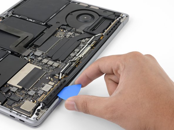

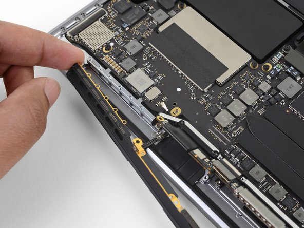

  24. MacBook Pro 13" Function Keys 2017 Display Assembly Replacement, Unseat the antenna assembly: crwdns2935265:024crwdnd2935265:01crwdnd2935265:03crwdne2935265:0 MacBook Pro 13" Function Keys 2017 Display Assembly Replacement, Unseat the antenna assembly: crwdns2935265:024crwdnd2935265:02crwdnd2935265:03crwdne2935265:0 MacBook Pro 13" Function Keys 2017 Display Assembly Replacement, Unseat the antenna assembly: crwdns2935265:024crwdnd2935265:03crwdnd2935265:03crwdne2935265:0
    • Use an opening pick to lever out the antenna cable assembly in the areas shown.
    • Don't slide the opening pick from side to side, as there are two display cables in the way that may be damaged.
  25. MacBook Pro 13" Function Keys 2017 Display Assembly Replacement, Remove the antenna assembly: crwdns2935265:025crwdnd2935265:01crwdnd2935265:03crwdne2935265:0 MacBook Pro 13" Function Keys 2017 Display Assembly Replacement, Remove the antenna assembly: crwdns2935265:025crwdnd2935265:02crwdnd2935265:03crwdne2935265:0 MacBook Pro 13" Function Keys 2017 Display Assembly Replacement, Remove the antenna assembly: crwdns2935265:025crwdnd2935265:03crwdnd2935265:03crwdne2935265:0
    • Carefully remove the antenna assembly, while simultaneously feeding the antenna cable bundle through the hole in the chassis.
  26. MacBook Pro 13" Function Keys 2017 Display Assembly Replacement: crwdns2935265:026crwdnd2935265:01crwdnd2935265:01crwdne2935265:0
    • Remove the antenna cable assembly.
    • During reassembly, gently pinch the cable bundle together and guide through the hole in the chassis into the correct position on the board. If needed, use your tools to help guide it through, but don't force it.

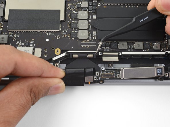

  27. MacBook Pro 13" Function Keys 2017 Display Assembly Replacement, Unscrew the display cable assembly: crwdns2935265:027crwdnd2935265:01crwdnd2935265:01crwdne2935265:0
    • Remove the four 3.9 mm T3 Torx screws securing the cover springs on the two display cables.
  28. MacBook Pro 13" Function Keys 2017 Display Assembly Replacement, Remove the display cable assembly: crwdns2935265:028crwdnd2935265:01crwdnd2935265:03crwdne2935265:0 MacBook Pro 13" Function Keys 2017 Display Assembly Replacement, Remove the display cable assembly: crwdns2935265:028crwdnd2935265:02crwdnd2935265:03crwdne2935265:0 MacBook Pro 13" Function Keys 2017 Display Assembly Replacement, Remove the display cable assembly: crwdns2935265:028crwdnd2935265:03crwdnd2935265:03crwdne2935265:0
    • Grab the left side of the display cable assembly and pull it towards the bottom end of the MacBook and away from the cover spring.
    • Use a pair of tweezers to pull the cover spring on the display cable out of its recess.
    • Repeat this step with the right cover spring.
