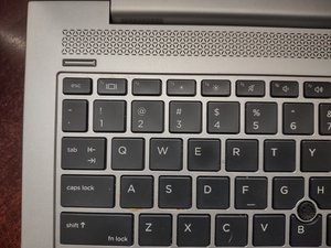

Due to the additional panel options (with many including SureView, so I’ve put a photo in this answer to quickly tell), these machines are bit trickier to source the parts on blindly, unlike the G3/G4. For the G3/4 you either had a crappy 768p TN panel, or a FHD IPS LCD (recommended). I have two of these G5 machines in production, so I’m familiar with how variable things can be in terms of the factory screen. You sort of need-to-know which unit you have because of the SureView option!

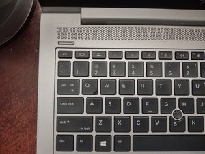

IF you are deleting SureView, you will have this keyboard. Thankfully, you can ignore the SureView function as the computer just ignores it when you fail to activate SureView because the panel is in the trash where it belongs. The problem is in order to remove it (and save a ton of cash), you need to get the cable and screen due to the modified connector - which is why I blocked this off as a dedicated point. It is specially marked as a PRIV part, so it can’t be used on a 4K LCD. The SureView option is infuriating because so many machines have it in business and healthcare (blame HIPAA) but SOMEHOW the price of the SV panel and the related parts do not match how many of these are seemingly equipped with it. Any non-factory SV machine is an uncommon sight, like my 4K non-SV machine. Thankfully, it doesn’t matter once it’s removed as the SV key stops working when the panel is removed. The function simply “dies” until you add the panel and cable back.
If you have this keyboard, go for 4K IPS, or FHD IPS - your call. No parts needed unless you upgrade a FHD IPS notebook to 4K.
