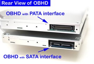

Is this drive look nonstandard?
Individual drive:
Compared to a normal IDE laptop optical drive:
Since my primary external drive is one of those with a soldered USB port (and is a throwaway when it fails), I found two laptop optical drives that I haven’t used in years - one of which is a HP Lightscribe drive (I know the LS functions aren’t really practical today, but it will work as a standard burner) and a drive I pulled from an T43 that was a parts machine. The IBM drive is the one I don’t know if this is standard or one of the many nonstandard connectors IBM has created. I think it’s nonstandard because it doesn’t look right (and it’s an IBM drive), but I have also read this is a standard IDE drive (UJ-822B) so it may be a hotswap friendly connector based on the IDE specification - I’m not entirely sure.
Is this drive look like a standard IDE drive I can get an enclosure for (albeit hard to find) or is it look like it’s a proprietary IBM part?
They are both non-standard. This is the one I would look for:
The HP drive (bottom) is standard IDE. They didn't do anything special to the drive like IBM may have.
