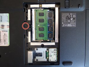

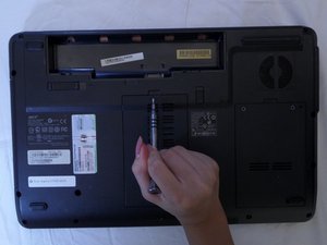

If you use it enough to warrant replacing it, you will need to remove the drive, look the model number up to see if it is 9.5 or 12.7mm and order a replacement online - you don't need to use the drive Acer used if you can't find a direct match that's new. All you need to do to access it on this machine is remove the RAM/WiFi card door on yours. If you replace it, you will need to move the screw retention bracket to the new drive.
