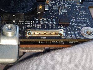

@danj Hi Dan,
So I took the logic board out and managed to take a picture for you. Can't say that the LVDS port is damaged in any way.
https://m.imgur.com/a/84aSklz

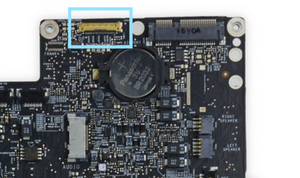

Hi @danj,
So I pressed the tabs down but I still get flickering.
See https://m.imgur.com/a/2EerdKP
I will say even with the locking arm down on the display cable, it does not take any force at all to pull it out of the socket.
Any ideas?
What does an external display look like? Does it show the same flickering?
@danj There is no flickering on an external display

As your external display is not showing any defects that focuses the issue to the internal display and its connections to the logic board. I fear you may have damaged the LVDS connector on the logic board.
When you pulled the display forward you may have yanked on the LVDS cable enough to distort the connector. Look down into the socket does one side look wider or pulled away?

Looking at your image it does appear the locking tabs on each end are bent out (marked in blue)
Place a Spudger behind the tab so you don’t go to far and carefully press it back down.
