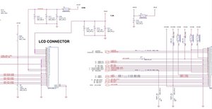

Whether LCD assembly, BIOS corrupted to not turn on backlight or a fault on the System Board… I am not sure. If anyone has a schematic for the i7 boards for the X240 or any ideas regarding how to repair without replacing the LCD assembly, please feel free to comment.

Hi @jayeff , Thanks for the feedback below as I needed the motivation to do what you note in regards to search for the schematic. I don't recall either if I noted anywhere else and doesn't look like I have on file. Did wind up finding that like you noted quicker than I expected. I'll edit the answer and add the screenshot since is like you note where there is one LCD cable where the backlight is incorporated and not much more than some fuses and caps that I can see from my newbie experience that can fail potentially.
@jafinch78 ,
Great work on finding the schematic.
If all the power supply fuses etc are OK and you have power on the relevant pins at the 30 pin connector it may be worth checking where the LEDPWR lead (pin 28) comes from. (find other ref. point 45 perhaps)
My guess is that wire is used to signal to the display to turn on/off the LED backlights since the power will already be there. Looking at the circuit it's not as though the LED power supplies are being switched on and off on the motherboard, they're directly wired into the connector
Also check the LID_ CLOSE lead (pin 2) as this will tell the LEDPWR lead (via BIOS I assume) to turn off the backlights. The capacitor (or resistor) may be faulty (or something else further in the circuit) so the BIOS might think that the lid is closed and turn off the backlights
