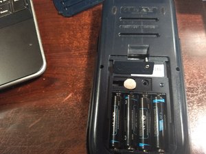

My calculator, out of nowhere started turning itself off randomly and resetting the RAM constantly. Sometimes I can turn it ON and use it for a few minute but other times if I just touch it or press any key it will immediately turn off. I have tried changing both batteries and didn’t work. What else should I do? Any idea of what might be?
The LR44 is dead and needs to be replaced. You will need a #0 Phillps to change it on the TI-84. Once you remove the cover as the screw is captive, pop the old cell out with a flathead screwdriver and install a new one. Refer to this photo as to where it is replaced:

@nick I don’t think it’s the coin battery as I checked its voltage and it was pretty close to the voltage of the battery, don’t remember how much exactly so I assumed it was good but I can try to replace it.
The reason I think it’s not because of the battery is because sometimes the calculator just turns off if I touch on it or move it, it’s weird, but I’ll try to replace the battery. Thanks
The coin cell can look okay but may not have much charge left. The LR44 TI uses from the factory (NL in mine) is a 144mAh cell. Others may hold more but the OEM LR44 isn't long lasting.
They're only a few bucks so if doesn't hurt to try if you already lost the RAM backed content.

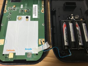

Hi, check this figure. For the randomly turning off issue, you may fix it by soldering the anode of the battery to the PCB board anode points (any of these blue circle positions are the same anode if you check it with your multimeter).
The electric contact of TI-84 Plus is problematic. Whenever the contact surface area is insufficient or the current demand is large, the calculator circuit will draw electron from the anode material (which is the copper in TI-84 Plus) and rust the anode until the material is consumed and break the contact totally.
Hope this will help you.
The anode position may different depends on the version. It’s better to check the resistance of the contact points to be 0!
Now it’s working perfectly.
BTW, if your RAM is clearing randomly, you may want to solder the ground (that spring) of the button cell to the anode contact as the picture shown.

@nick do you mean the main-power NiMh swap or the swap applied to the button cell power, too? I think they're two different cases with the same poor contact issue. The RAM is sustained by the button cell, whereas the turning off is due to the main-power contactless.
